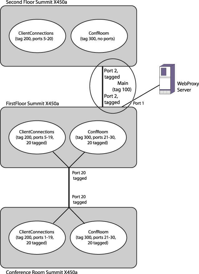

PVLAN Configuration Example 2
The following figure shows a PVLAN configuration example for a motel.
The motel example in the following figure has guest rooms, a conference room, and their web proxy server on the first floor, and guest rooms on the second floor. The motel has three Summit switches. There is one on the first floor in a closet, one on the first floor in the conference room, and one on the second floor.
The PVLAN in the following figure contains the following PVLAN components:
  • A VLAN called Main that contains the web proxy server.
  • A VLAN called ConfRoom that contains the ports for the conference room connections.
  • A VLAN called ClientConnections that contains client PC connections for the guest rooms.
The goals for the motel network are as follows:
  • Provide internet access for the ConfRoom and ClientConnections VLANs through the web proxy server.
  • Prevent communications between the ConfRoom and ClientConnections VLANs.
  • Enable communications between clients on the ClientConnections VLAN only within the conference room.
  • Enable communications between devices on the ConfRoom VLAN.
  • Prevent communications between the PCs in the ClientConnections VLAN that are not in the conference room.
Notice the following in the above figure:
  • The Summit switches in the first floor closet and on the second floor contain the Main VLAN with a tag of 100. This VLAN is connected via a tagged port between the first and second floor switches.
  • The Summit in the conference room does not contain the Main VLAN and cannot be a PVLAN member.
  • All of the switches have the ClientConnections VLAN, and it uses VLAN tag 200.
  • All of the switches have the ConfRoom VLAN, and it uses VLAN tag 300.
  • The Conference Room Summit connects to the rest of the network through a tagged connection to the Summit in the first floor closet.
  • Because the Summit in the first floor closet is a PVLAN member and uses the same port to support two subscriber VLANs, a loopback port is required in all subscriber VLANs, except the first configured subscriber VLAN (this applies to all switches and Summit family switches).
