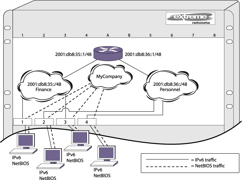

The figure below illustrates a switch with three VLANs defined as follows:
  • Finance
    • Protocol-sensitive VLAN using IPv6 protocol
    • All ports on slots 1 and 3 have been assigned.
    • IP address 2001:db8:35::1/48.
  • Personnel
    • Protocol-sensitive VLAN using the IPv6 protocol.
    • All ports on slots 2 and 4 have been assigned.
    • IP address 2001:db8:36::1/48.
  • MyCompany
    • Port-based VLAN.
    • All ports on slots 1 through 4 have been assigned.
IPv6 Unicast Routing Configuration Example
The stations connected to the system generate a combination of IPv6 traffic and NetBIOS traffic. The IPv6 traffic is filtered by the protocol-sensitive VLANs. All other traffic is directed to the VLAN MyCompany.
In this configuration, all IPv6 traffic from stations connected to slots 1 and 3 have access to the router by way of the VLAN Finance. Ports on slots 2 and 4 reach the router by way of the VLAN Personnel. All other traffic (NetBIOS) is part of the VLAN MyCompany.
