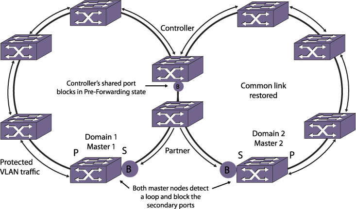

During normal operation, the master node on each ring protects the ring as described in EAPS Single Ring Topology. The controller and partner nodes work together to protect the overlapping VLANs from problems caused by a common link failure or a failed controller (see the following figure).
Master Node Operation in a Multiple Ring Topology
If a link failure occurs in one of the outer rings, only a single EAPS domain is affected. The EAPS master detects the failure in its domain, and converges around the failure. In this case, the controller does not take any blocking action, and EAPS domains on other rings are not affected. Likewise, when the link is restored, only the local EAPS domain is affected. The controller and any EAPS domains on other rings are not affected, and continue forwarding traffic normally.

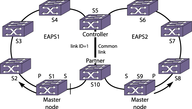

To detect common-link faults, the controller and partner nodes send segment health check messages at one-second intervals to each other through each segment. A segment is the ring communication path between the controller and partner. The common link completes the ring, but it is a separate entity from the segment. To discover segments and their up or down status, segment health-check messages are sent from controller to partner, and also from partner to controller (see the following figure).
Segment Health-Check Messages

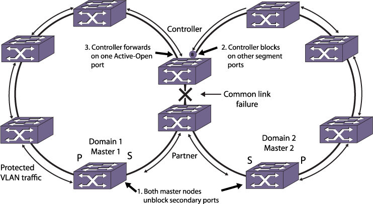

With one exception, when a common link fails, each master node detects the failure and unblocks its secondary port, as shown in the following figure.
Common Link Failure
Because the secondary port of each master node is now unblocked, the new topology introduces a broadcast loop spanning the outer rings.
The controller and partner nodes immediately detect the loop, and the controller does the following:
  • Selects an active-open port for protected VLAN communications.
  • Blocks protected VLAN communications on all segment ports except the active-open port.

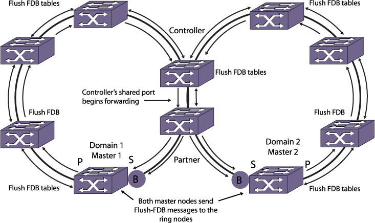

When a common link recovers, each master node detects that the ring is complete and immediately blocks their secondary ports. The controller also detects the recovery and puts its shared port to the common link into a temporary blocking state called pre-forwarding as shown in the following figure.
Common Link in Pre-Forwarding State
Because the topology has changed, the EAPS nodes must learn the new traffic paths. Each master node notifies all switches in their domain to clear their FDB tables, and traditional Ethernet bridge learning and forwarding mechanisms establish the new traffic paths. Once the controller receives flush-fdb messages for all of its connected EAPS domains, the controller shared-port state for the common link changes to forwarding, the controller state changes to Ready, and traffic flows normally as shown in the following figure.
