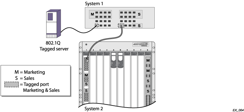

The following figure illustrates the physical view of a network that uses tagged and untagged traffic.
Physical Diagram of Tagged and Untagged Traffic
The following figure is a logical diagram of the same network.
Logical Diagram of Tagged and Untagged Traffic
In the figures above:
  • The trunk port on each switch carries traffic for both VLAN Marketing and VLAN Sales.
  • The trunk port on each switch is tagged.
  • The server connected to port 25 on System 1 has a NIC that supports 802.1Q tagging.
  • The server connected to port 25 on System 1 is a member of both VLAN Marketing and VLAN Sales.
  • All other stations use untagged traffic.
As data passes out of the switch, the switch determines if the destination port requires the frames to be tagged or untagged. All traffic coming from and going to the server is tagged. Traffic coming from and going to the trunk ports is tagged. The traffic that comes from and goes to the other stations on this network is not tagged.
