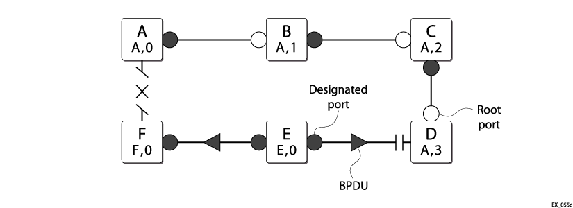

In this example, the bridge priorities are assigned based on the order of their alphabetical letters; bridge A has a higher priority than bridge F.
Suppose you have a network, as shown in the following figure, with six bridges (bridge A through bridge F) where the following is true:
Initial Network Configuration
The network reconverges in the following way:

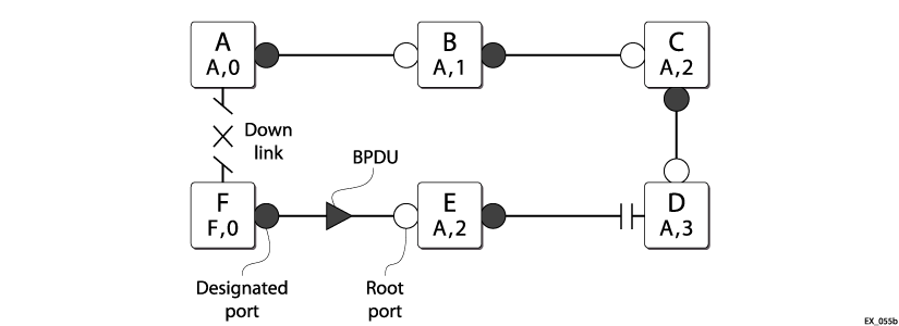

If the link between bridge A and bridge F goes down, bridge F detects the root port is down. At this point, bridge F:
As shown in the following figure, after the configuration update, bridge F:

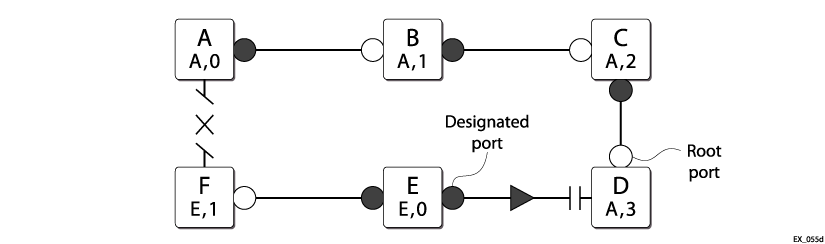

As shown in the following figure, after the configuration update, bridge E:
New Root Bridge Selected
As shown in the following figure, when bridge F receives the superior BPDU and configuration update from bridge E, bridge F:
  • Decides that the receiving port is the root port.
  • Determines that bridge E is the root bridge.
Communicating New Root Bridge Status to Neighbors
Bridge D believes that bridge A is the root bridge. When bridge D receives the BPDU from bridge E on its alternate port, bridge D:
  • Immediately begins the max age timer on its alternate port.
  • Performs a configuration update.
As shown in the following figure, after the configuration update, bridge D:

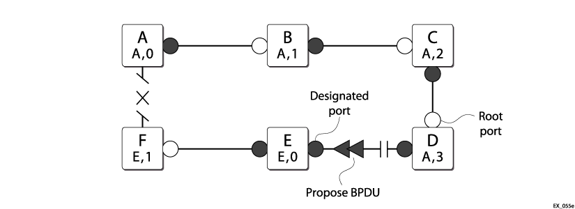

Sending a Propose Message to Confirm a Port Role
Upon receiving the proposal, bridge E (as shown in the following figure):
  • Changes its receiving port to a root port.
The existing designated port enters the blocking state.
Bridge E then sends:

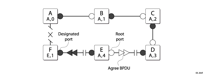

Communicating Port Status to Neighbors
To complete the topology change (as shown in the following figure):
  • Bridge D moves the port that received the “agree” message into the forwarding state.
  • Bridge F confirms that its receiving port (the port that received the “propose” message) is the root port, and immediately replies with an “agree” message to bridge E to unblock the proposing port.

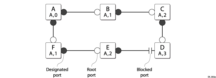

Completing the Topology Change
The following figure displays the new topology.
Final Network Configuration
