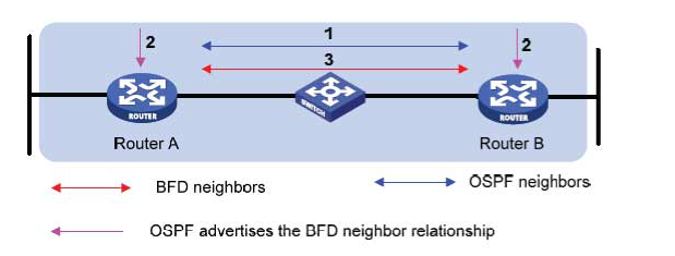

Basic Operational Flow of OSPF BFD
Establishing a BFD Session for OSPF Neighbor
  1. OSPF discovers a neighbor.
  2. If BFD for OSPF is configured, OSPF on both routers sends a request to the local BFD server to initiate a BFD neighbor session with the OSPF neighbor router.
  3. The BFD neighbor session with the OSPF neighbor router is established on both sides if BFD session limit is not reached.
If the BFD session limit is reached, the OSPF neighbor will be marked as BFD session failed if synchronous request is used, or pending if asynchronous request is used, and the BFD server will send an asynchronous notification when the session registration passes later. (The asynchronous request is not available until the BFD client session create API is enhanced.)
Eliminating the OSPF Neighbor Relationship by BFD Fault Detection
  1. A failure occurs in the network.
  2. The BFD neighbor session with the OSPF neighbor router is removed because the BFD timer expired.
  3. On both Router A and Router B, BFD notifies the local OSPF process that the BFD neighbor is DOWN.
  4. The local OSPF process tears down the OSPF neighbor relationship by marking neighbor state DOWN. (If an alternative path is available, the routers will immediately start converging on it.)
OSPF Neighbor Relationship Eliminated by BFD Fault Detection
OSPF will request the BFD server to delete the BFD session for OSPF neighbor moved to DOWN state. When the link failure is later resolved, OSPF needs to register the re-discovered neighbor to BFD again to initiate BFD session creation.
