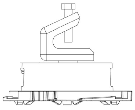

  5. Open the top screw as necessary and place the beam clip onto a beam.
    You must hold the access point when attaching the beam clip.
    ACC-BKT-AX-BEAM Accessory Bracket
    Circular beam clip accessory
  6. Tighten the beam clip top screw to a torque of 50 in-lbs.
