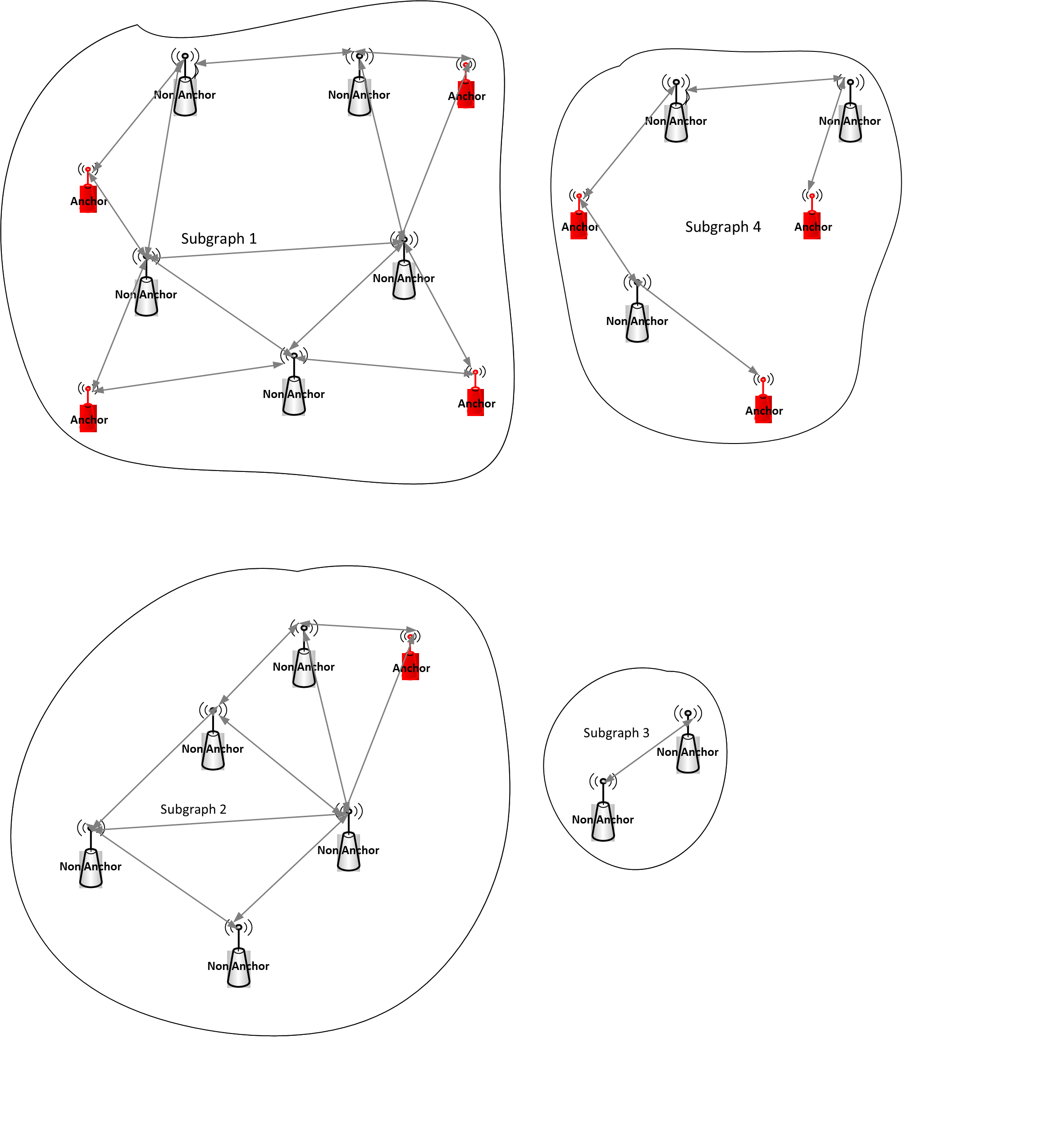

The Geo-Location Agent builds one or more AP graphs (subgraphs) for each floor plan to which APs are assigned, based on the FTM AP-to-AP ranging results. The graph boundaries are created from the measured distance between the APs, using the 802.11mc protocol. Where the AP graph is located on the map depends on the geo-location reported by the anchor APs.

Example Subgraph Scenarios
Subgraph 1
The group of APs belonging to Subgraph 1 satisfy the AP graph connectivity and the number of anchor AP requirements. As a result, the Geo-Location Agent successfully derived coordinates for each of them.
No corrective action required.
Subgraph 2
The group of APs belonging to Subgraph 2 satisfy the AP graph connectivity rules, but not the number of anchor AP requirements. As a result, the Geo-Location Agent did not derive coordinates for these APs.
Corrective action: Install more APs between Subgraph 1 and Subgraph 2 to add more connections between the subgraphs and merge them.
Subgraph 3
When the AP graph connectivity rule is not met, but the number of anchor APs requirement is met, geolocation coordinates are not derived.
Corrective action: Reposition the APs, or install more APs, to achieve connectivity with the rest of the APs on the floor.
Subgraph 4
When neither requirement is met, geo-location coordinates are not derived. Take the following corrective actions:
Corrective action: Reposition the APs or install more APs to achieve connectivity with the rest of the APs on the floor.
