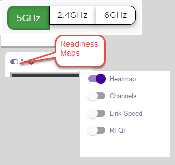

To access the maps:
From the right panel, select Maps to display a
list of map types.
To activate a map, select the
ball and drag to the right.

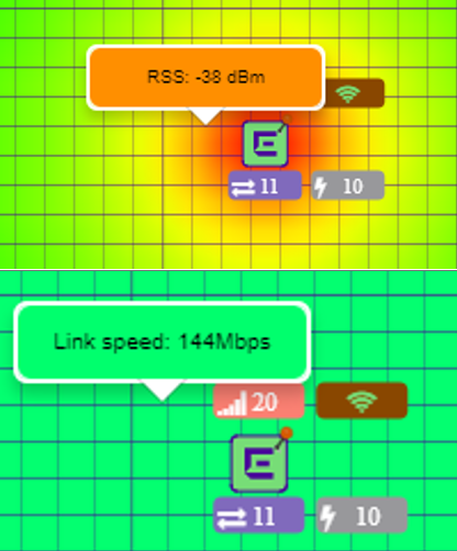

Right-click anywhere on a heatmap to view the numeric value at that
location on the map.
Push-Pin Reading for Heatmap Values
