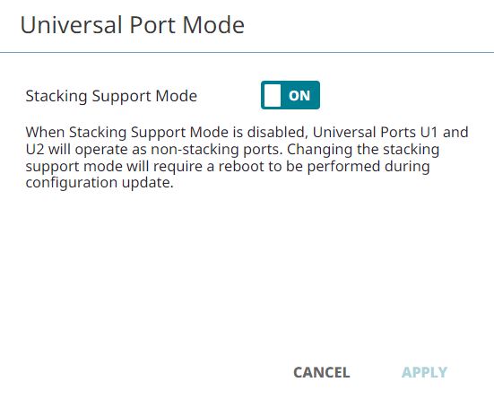

Changing the stacking support mode requires a reboot to be performed during configuration update.
To Enable or Disable Universal Port Stacking Support Mode:
The default channelization option for 4120 models is 1x100G.
Universal Port Stacking Support Mode can also be configured at the device-level, within the Port / VLAN Configuration page. Device level configuration will override the template configuration.
