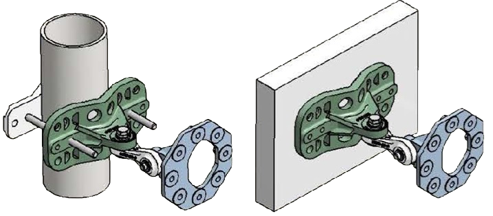

MNT-22 Mount
Procedure
  1. Unpack the antenna from the shipping materials.​
  2. Assemble the mounting bracket. The pivot screws should be only finger-tight.​
  3. Mount the mounting bracket to the wall or pole.
    Tighten the non-pivot mounting hardware to 45 inch-lbs and tighten the pole cable strap screw so they are tight and cannot be moved on the pole.
  4. Assemble the antenna to the mounting bracket.
    Tighten the nuts to 45 inch-lbs.

  6. Adjust the mounting bracket angles so the panel antenna is pointing in the desired direction.
    Tighten the pivot screws to 50 -inch lbs.
