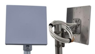

The AI-TQ08055 antenna.
The AI-TQ08055 antenna is an indoor panel antenna that measures 250mm x 250mm x 25mm (9.84in x 9.84in. x 0.98in) and weighs 0.86 kg (1.9 lbs). It ships with a mounting bracket.
Procedure
  1. Unpack the antenna from the shipping materials.​ ​​
  2. Assemble the mounting bracket. The pivot screws should be only finger-tight.​
  3. Mount the mounting bracket to the wall or pole.
    Tighten the non-pivot fasteners to 45-inch lbs.​
  4. Assemble the antenna to the mounting bracket. Tighten the nuts to 45-inch lbs.​
  5. Attach the four cables to the AP for the specified frequencies. Tighten the RP-SMA connectors to 5 inch-pounds. See the AP installation guide for information on connecting the antenna to the correct ports.
