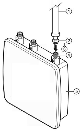

Weatherproofing the Antenna
1Antenna4Type-N jack
2Nut5AP
3Standard polarity Type-N plug6Sealing tape (recommended, but not supplied)
Procedure
  1. Secure the antenna in place by tightening the single nut.
  2. Follow the manufacturer's instructions provided in the kit to seal the connection between the Type-N jack and the Type-N plug.
