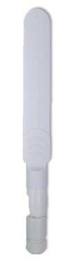

AI-TS06360 Antenna
The AI-TS06360 antenna.
The AI-TS06360 antenna is a tri-band antenna designed for indoor use. It measures 158 mm x 17.7 mm x 6 mm (6.22 inches x 0.69 inches x 0.23 inches) and weighs 14.76 g (0.032 lbs).
Procedure
  1. Unpack the antenna from the shipping materials.​ ​
  2. Thread the antennas onto the AP's external RP-SMA connectors.​ ​
    See the AP installation guide for information on connecting the antenna to the correct ports.
  3. Tighten the antennas onto the RP-SMA connectors to a torque of 5 inch-pounds.
