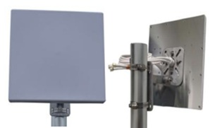

AI-TQ06120 Antenna
The AI-TQ06120 antenna.
The AI-TQ06120 antenna is an indoor panel antenna that measures 250mm x 250mm x 25mm (9.84in x 9.84in. x 0.98in) and weighs 0.72 kg (1.59 lbs). It ships with a mounting bracket.
