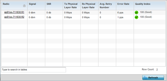

To view connected radio RF statistics:
The screen displays.
| Radio | Displays the name assigned to each listed radio. Each radio name displays as a link that can be selected to display radio information in greater detail. |
| Signal | Displays the power of each listed radio signals in dBm. |
| SNR | Displays the signal to noise ratio of
each listed radio. SNR is a measure that compares the level of a desired signal to the level of background noise. It is defined as the ratio of signal power to the noise power. A ratio higher than 1:1 indicates more signal than noise. |
| Tx Physical Layer Rate | Displays the data transmit rate for each managed radio's physical layer. The rate is displayed in Mbps. |
| Rx Physical Layer Rate | Displays the data receive rate for each managed radio's physical layer. The rate is displayed in Mbps. |
| Avg Retry Rate | Displays the average number of retries for each radio. |
| Error Rate | Displays the average number of retries per packet. A high number indicates possible network or hardware problems requiring administration to improve performance. |
| Quality Index |
Displays the client's RF quality. The RF quality index is the overall effectiveness of the RF environment, as a percentage of the connect rate in both directions as well as the retry rate and the error rate. RF quality index value can be interpreted as:
