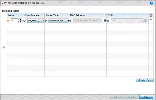

    WIPS Device Categorization - Configuration Screen
  4. If you are creating a new Device Categorization policy, provide it a name (up to 64 characters) to distinguish this policy from others with similar configurations.
    Select OK to save the name and enable the remaining parameters on the screen.
  5. Select + Add Row to populate the Marked Devices field with parameters for adding an access point‘s MAC address, SSID, access point designation, and network authorization.
    Select the red (-) Delete Row icon as needed to remove an individual table entry.
  6. Define the following parameters to add a device to a list of devices categorized as sanctioned or unsanctioned for network operation:
    Index Use the spinner controls to set the Index number for each Device Categorization Name.
    Classification Use the drop-down menu to designate the target device as either sanctioned (True) or unsanctioned (False). The default setting is False, categorizing this device as unsanctioned. Thus, each added device requires authorization. A green check mark designates the device as sanctioned, while a red “X” defines the device as unsanctioned.
    Device Type Use the drop-down menu to designate the target device as either an access point (True) or other (False). The default setting is False, categorizing this device as other than an access point. A green check mark designates the device as an access point, while a red “X” defines the categorized device as other than an access point.
    MAC Address Enter the factory coded MAC address of the target device. This address is hard coded by the device manufacturer and cannot be modified. The MAC address will be defined as sanctioned or unsanctioned as part of the device categorization process.
    SSID Enter the SSID of the target device requiring categorization. The SSID cannot exceed 32 characters.
  7. Select OK to save the updates to the Marked Devices list.
