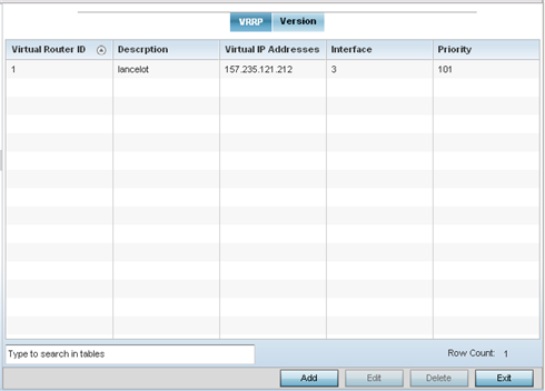

To define the configuration of a VRRP group:
Select the Configuration → Profiles → Manage Profiles tab from the Web UI.
Select VRRP.
Review the following VRRP configuration data to assess if a new VRRP configuration is required or if an existing VRRP configuration requires modification or removal:
Virtual Router ID |
Lists a numerical index (1 - 254) used to differentiate VRRP configurations. The index is assigned when a VRRP configuration is initially defined. This ID identifies the virtual router a packet is reporting status for. |
Description |
Displays a description assigned to the VRRP configuration when it was either created or modified. The description is implemented to provide additional differentiation beyond the numerical virtual router ID. |
Virtual IP Addresses |
Lists the virtual interface IP address used as the redundant gateway address for the virtual route. |
Interface |
Displays the device interfaces selected to supply VRRP redundancy failover support. |
Priority |
Lists a numerical value (1 - 254) used for the virtual router master election process. The higher the numerical value, the higher the priority in the election process. |
Select Add button to create a new VRRP configuration. Select Edit to update an existing VRRP configuration.
