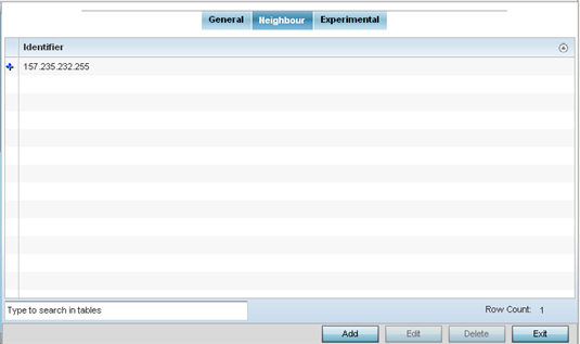

  14. Select the Neighbor tab.
    The BGP Neighbor Identifier screen displays. This screen displays a list of configured BGP neighbor devices identified by their IP address.
    Border Gateway Protocol - Neighbor tab
  15. Select Add to add a new BGP neighbor configuration or select an existing Identifier and select Edit to modify it. The following screen displays with the General tab selected by default.

  28. Select the Experimental tab.
    This is an experimental feature and its actual operation may be unpredictable.
    Border Gateway Protocol - Add/Edit - Neighbor - Experimental Tab
  29. Set the following Experimental BGP neighbor parameters:
