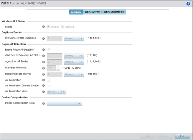

    If you are adding or editing an existing WIPS policy, the WIPS Policy screen displays with the Settings tab displayed by default.
    WIPS Policy Screen - Add/Edit - Settings Tab
  5. If you are creating a new WIPS Policy, assign it name to help differentiate it from others that may have a similar configuration.
    The policy name cannot exceed 64 characters. The name cannot be modified as part of the edit process.
  6. Within the Wireless IPS Status field, select either Enabled or Disabled to activate or deactivate the WIPS policy.
    The default setting is Enabled.
  7. Enter the Interval to Throttle Packets in either seconds (1 - 86,400), minutes (1 - 1,400), hours (1 - 24) or days (1).
    This interval represents the duration event duplicates are not stored in history. The default setting is 2 minutes.
  8. Refer to the Rogue AP Detection field to define the following detection settings for this WIPS policy:
    Enable Rogue AP Detection Select the check box to enable the detection of unauthorized (unsanctioned) devices for this WIPS policy. The default setting is Disabled.
    Wait Time to Determine AP Status Define a wait time in either seconds (10 - 600) or minutes (1 - 10) before a detected AP is interpreted as a rogue (unsanctioned) device, and potentially removed. The default interval is 1 minute.
    Ageout for AP Entries Set the interval the WIPS policy uses to age out rogue devices. Set the policy in either seconds (30 - 86,400), minutes (1- 1,440), hours (1 - 24) or days (1). The default setting is 5 minutes.
    Interferer Threshold Specify an RSSI threshold (from -100 to -10 dBm) after which a detected access point is classified as an interferer (rogue device).
    Recurring Event Interval Set an interval that, when exceeded, duplicates a rogue AP event if the rogue devices is still active (detected) in the network. The default setting is 5 minutes.
    Air Termination Select this option to enable the termination of detected rogue AP devices. Air termination lets you terminate the connection between your wireless LAN and any access point or client associated with it. If the device is an access point, all clients dis-associated with the access point. If the device is a client, its connection with the access point is terminated. This setting is disabled by default.
    Air Termination Channel Switch Select this option to allow neighboring access points to switch channels for rogue AP termination. This setting is disabled by default.
    Air Termination Mode If termination is enabled, use the drop-down menu to specify the termination mode used on detected rogue devices. The default setting is manual.
