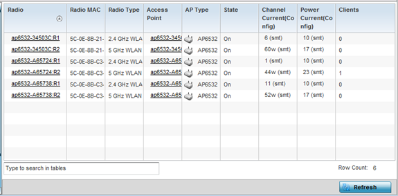

The Status screen displays network address, access point model, operational channel and client device status information for detected RF Domain member device radios serving and client support resources for the selected RF Domain.
To view the RF Domain radio statistics:
The RF Domain statistics menu displays in the right-hand side of the screen, with the Health tab selected by default.
The Radios → Status screen displays by default.
| Radio | Displays the name assigned to each listed RF Domain member access point radio. Each name displays as a link that you can be select to view radio information in greater detail. |
| Radio MAC | Displays the MAC address as a factory-set, numerical value hard coded for each listed RF Domain member AP radio. |
| Radio Type | Defines whether the radio is operating within the 2.4 or 5 GHz radio band |
| Access Point | Displays the user assigned name of the RF Domain member access point to which the radio resides. |
| AP Type | Lists the model type of each listed RF Domain member AP. |
| State | Displays the radio's current operational state. |
| Channel Current (Config) | Displays the current channel each listed RF Domain member AP radio is broadcasting on. |
| Power Current (Config) | Displays the current power level the radio is using for transmissions. |
| Clients | Displays the number of clients currently connected to each listed RF Domain member AP radio. Supported models can manage up to 256 clients per radio. |
