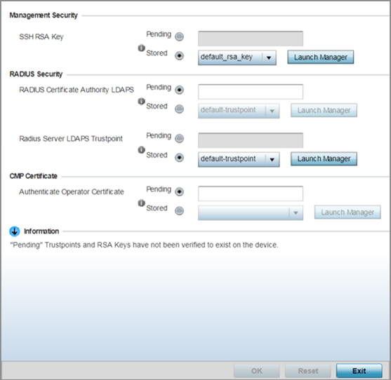

To configure certificate usage:
| SSH RSA Key | Either use the default_rsa_key or select Stored to enable a drop-down menu where an existing certificate can be used. To use an existing key, select Launch Manager. For more information, see RSA Key Management . |
Pending trustpoints and RSA keys are typically not verified as existing on a device.
RADIUS Certificate Authority |
Either use the default-trustpoint or select Stored to enable a drop-down menu where an existing certificate can be used. To use an existing certificate, select Launch Manager. |
RADIUS Server Certificate |
Either use the default-trustpoint or select Stored to enable a drop-down menu where an existing certificate/trustpoint can be used. To use an existing trustpoint, select Launch Manager. |
RADIUS Certificate Authority LDAPS |
Either use the LDAP server default-trustpoint or select Stored to enable a drop-down menu where an existing certificate can be used. To use an existing certificate, select Launch Manager. |
RADIUS Server LDAPS Trustpoint |
Either use the LDAP server default-trustpoint or select Stored to enable a drop-down menu where an existing certificate/trustpoint can be used. To use an existing trustpoint, select Launch Manager. |
Either use the server default-trustpoint or select Stored to enable a drop-down menu where an existing certificate/trustpoint can be used. To use an existing trustpoint, select Launch Manager.
