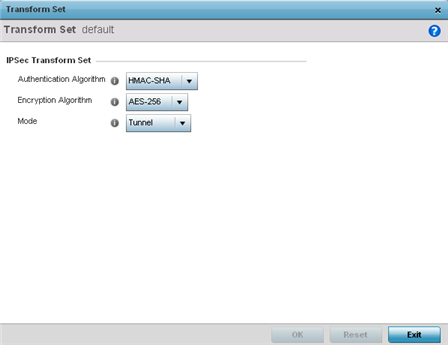

To add or edit a profile's VPN transform set:
Go to Configuration → Profiles → Manage Profiles .
Select a target profile from those displayed on the screen.
Expand Security and select VPN..
Select the Transform Set tab.
Select Add to define a new transform set configuration, Edit to modify an existing configuration or Delete to remove an existing transform set.
Define the following settings for the new or modified transform set configuration:
Name |
If creating a new transform set, define a 32 character maximum name to differentiate this configuration from others with similar attributes. |
Authentication Algorithm |
Set the transform sets's authentication scheme used to validate identity credentials. Use the pull-down menu to select either HMAC-SHA or HMAC-MD5. The default setting is HMAC-SHA. |
Encryption Algorithm |
Set the transform set encryption method for protecting transmitted traffic. Options include DES, 3DES, AES, AES-192 and AES-256. The default setting is AES-256. |
Mode |
Use the pull-down menu to select either Tunnel or Transport as the IPSec tunnel type used with the transform set. Tunnel is used for site-to-site VPN and Transport should be used for remote VPN deployments. |
Select OK to save the changes made within the Transform Set screen. Select Reset to revert to the last saved configuration
