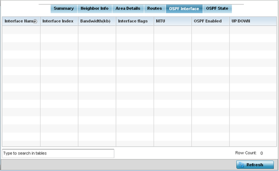

To view OSPF interface statistics:
| Interface Name |
Displays the IP addresses and mask defined as the virtual interface for dynamic OSPF routes. Zero config and DHCP can be used to generate route addresses, or a primary and secondary address can be manually provided. |
| Interface Index |
Lists the numerical index used for the OSPF interface. This interface ID is in the hello packets establishing the OSPF network connection. |
| Bandwidth |
Lists the OSPF interface bandwidth (in Kbps) from 1 - 10,000,000. |
| Interface Flag |
Displays the flag used to determine the interface status and how to proceed. |
| MTU |
Lists the OSPF interface MTU (maximum transmission unit) size. The MTU is the largest physical packet size (in bytes) a network can transmit. Any packets larger than the MTU are divided into smaller packets before being sent. |
| OSPF Enabled |
Lists whether OSPF has been enabled for each listed interface. OSPF is disabled by default. |
| UP/DOWN |
Displays whether the OSPF interface (the dynamic route) is currently up or down for each listed interface. An OSPF interface is the connection between a router and one of its attached networks. |
