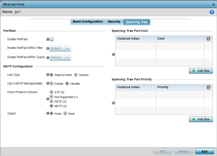

To edit or override spanning tree configuration of the selected port:
Enable as Edge Port |
Select this option to define this port as an edge port. Using an edge (private) port, you can isolate devices to prevent connectivity over this port. |
Link Type |
Select either Point-to-Point or Shared. When Point-to-Point is selected, the port is treated as connected to a point-to-point link. When Shared is selected, the port is shared between multiple devices. An example of a Point-to-Point connection is a port that is connected to a controller or service platform. An example of a Shared connection is a port that is connected to a hub. |
Cisco MSTP Interoperability |
Enable or Disable interoperability with Cisco‘s version of MSTP over the port. Cisco's version of MSTP is incompatible with standard MSTP. |
Force Protocol Version |
Select STP to use the standard Spanning Tree Protocol. Select RSTP to use Rapid Spanning Tree Protocol. Select MSTP to use Multiple Spanning Tree Protocol. Select Not Supported to disable spanning tree protocol for this interface. MSTP is the default setting. |
Guard |
Select Root radio to ensure that the port is a designated port. Typically, each guard root port is a designated port, unless two or more ports (within the root bridge) are connected together. If the bridge receives superior BPDUs on a guard root-enabled port, the guard root moves the port to a root-inconsistent STP state. This state is equivalent to a listening state. No data is forwarded across the port. Thus, the guard root enforces the root bridge position. Select None to disable this feature. |
Enable PortFast |
Select this option to enable drop-down menus for both the Enable PortFast BPDU Filter and Enable PortFast BPDU Guard options for the port. Enable PortFast to reduce the time taken for a port to complete the MSTP state changes from Blocked to Forward. Enable PortFast only on ports on the wireless controller which are directly connected to a server/workstation and not to another hub or controller. PortFast can be left unconfigured on an access point. |
Enable PortFast BPDU Filter |
Select this option to invoke a BPDU filter for this PortFast enabled port. MSTP BPDUs are messages that are exchanged when controllers gather information about the network topology. When enabled, PortFast enabled ports do not transmit BPDU messages. When this value is set to Default, the BPDU Filter value is set to the bridge's BPDU filter value. |
Enable PortFast BPDU Guard |
Select this option to invoke a BPDU guard for this PortFast enabled port. MSTP BPDUs are messages that are exchanged when controllers gather information about the network topology. When enabled, PortFast enabled ports are forced to shut down when they receive BPDU messages. When this value is set to Default, the PortFast BPDU Guard value is set to the bridge's BPDU guard value. |
Define or override an Instance Index using the spinner control, and set its corresponding cost in the Cost column.
This is the cost for a packet to traverse the current network segment. The cost of a path is the sum of all costs of traversal from the source to the destination. The default rule for the cost of a network segment is, the faster the media, the lower the cost.
The default path cost depends on the user-defined speed of the port. The cost helps determine the role of the port in the MSTP network. The designated cost is the cost for a packet to travel from this port to the root in the MSTP configuration. The slower the media, the higher the cost.
Spanning Tree Port Cost
Speed |
Default Path Cost |
<=100,000 bits/sec |
200000000 |
<=1,000,000 bits/sec |
20000000 |
<=10,000,000 bits/sec |
2000000 |
<=100,000,000 bits/sec |
200000 |
<=1,000,000,000 bits/sec |
20000 |
<=10,000,000,000 bits/sec |
2000 |
<=100,000,000,000 bits/sec |
200 |
<=1,000,000,000,000 bits/sec |
20 |
2 |
Select + Add Row as needed to include additional indexes.
Define or override an Instance Index using the spinner control, and set its corresponding priority in the Priority column.
This is the priority for this port becoming a designated root. The default rule is, the lower this value, the higher the chance that the port is assigned as a designated root.
