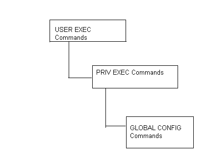

The CLI is segregated into different command modes. Each mode has its own set of commands for configuration, maintenance, and monitoring. The commands available at any given time depend on the mode you are in, and to a lesser extent, the particular model used. Enter a question mark (?) at the system prompt to view a list of commands available for each command mode/instance.
Use specific commands to navigate from one command mode to another. The standard order is: USER EXEC mode, PRIV EXEC mode and GLOBAL CONFIG mode.
A session generally begins in the USER EXEC mode (one of the two access levels of the EXEC mode). For security, only a limited subset of EXEC commands are available in the USER EXEC mode. This level is reserved for tasks that do not change the device‘s (wireless controller, service platform, or AP) configuration.
ap505-13403B>
The system prompt signifies the device name and the last three bytes of the device MAC address.
To access commands, enter the PRIV EXEC mode (the second access level for the EXEC mode). Once in the PRIV EXEC mode, enter any EXEC command. The PRIV EXEC mode is a superset of the USER EXEC mode.
ap505-13403B>en ap505-13403B#
Most of the USER EXEC mode commands are one-time commands and are not saved across device reboots. Save the command by executing ‘commit‘ command. For example, the show command displays the current configuration and the clear command clears the interface.
Access the GLOBAL CONFIG mode from the PRIV EXEC mode. In the GLOBAL CONFIG mode, enter commands that set general system characteristics. Configuration modes, allow you to change the running configuration. If you save the configuration later, these commands are stored across device reboots.
Access a variety of protocol specific (or feature-specific) modes from the global configuration mode. The CLI hierarchy requires you to access specific configuration modes only through the global configuration mode.
ap505-13403B#configure terminal Enter configuration commands, one per line. End with CNTL/Z. ap505-13403B(config)#
You can also access sub-modes from the global configuration mode. Configuration sub-modes define specific features within the context of a configuration mode.
ap505-13403B(config)#aaa-policy test ap505-13403B(config-aaa-policy-test)#
ap505-13403B(config)#self ap505-13403B(config-device-94-9B-2C-13-40-38)#
