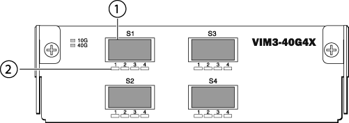

The VIM3-40G4X versatile interface module provides four unpopulated cages for QSFP+ optical modules or QSFP+ compatible direct-attach active or passive cables.
Ports S3 and S4 can be enabled as native stacking ports for the Summit X650 series switch.
Each physical port can be configured to operate as a single 40-Gbps port or as four 10-Gbps ports. When the port operates in 40-Gbps mode, you can connect the port using either a QSFP+ direct-attach cable or an installed QSFP+ module and compatible fiber optic cable. When the port is configured to operate in 10-Gbps mode, you must connect it using a special 1-to-4 breakout fiber optic cable.
The VIM3-40G4X module requires ExtremeXOS 12.6.1 software (or later) installed on the Summit X650 series switch.
| 1 = QSFP+ port | 2 = Port LEDs |
