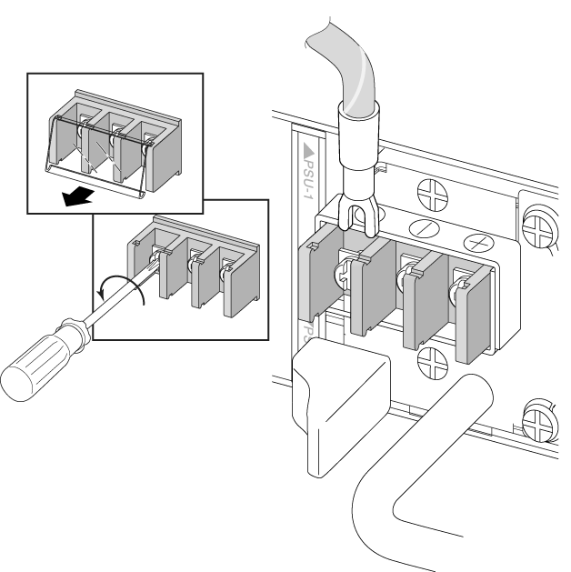

  5. Connect the ground wire to the grounding point as follows:
    1. Loosen the screw enough to allow the spade terminal to slide underneath the captive square washer.
      Connecting the Ground Wire
      ../Graphics/SH_159.svg
    2. Slide the spade terminal of the ground wire under the captive square washer.

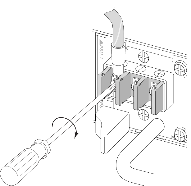

    3. Tighten the screw to 7 in‑lb (0.79 N m) as shown in Securing the Ground Wire.
