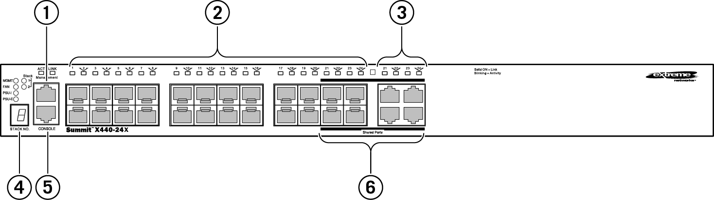

The front panel of the Summit X440-24x switch includes:
Summit X440-24x Switch Front Panel
../Graphics/X440_24x_front_panel.svg
1 = Ethernet management port 4 = Stack number indicator
2 = SFP ports 5 = Console port
3 = 10/100/1000BASE-T ports 6 = Combination ports

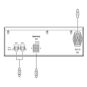

The rear panel of the Summit X440-24x switch includes:
  • Two high-performance stacking ports with associated LEDs.
  • Redundant power input connector for optional connection to the EPS-C2 External Power Module
    The connecting redundant power supply cable is shipped with the power module unit. See Installing an EPS-C2 Power Supply for more information.
  • AC power input socket.
    The internal AC power supply operates from 100 VAC to 240 VAC.
Summit X440-24x Switch Rear Panel
../Graphics/X440_24x_back_panel.svg
1 = AC power input connectors 3 = Redundant power connector
2 = Stacking ports
