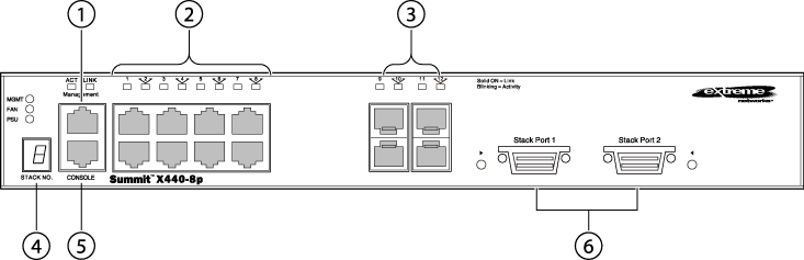

The front panel of the Summit X440-8p switch includes:
- Eight fixed autosensing 100/1000BASE-T PoE+ ports (ports 1–8).
In addition to 8 Gbps of high-density copper connectivity, these ports also supports
the PoE+ IEEE 802.3a standard and provide up to 30 Watts of power per port up to a
total power budget of 170 Watts.
- Four unpopulated SFP ports (ports 9–12) that provide 4 Gbps of
fiber connectivity. The SFP ports support both 100BASE-FX and 1000BASE-X optical
modules.
For information about SFPs, see the Extreme Networks Pluggable Transceivers Installation
Guide.
- Two high-performance stacking ports with associated LEDs.
- Ethernet management port.
- Serial console port implemented as an RJ45 connector, used to
connect a terminal and perform local management.
- LEDs to indicate port status and switch operating conditions.
For a description of the LEDs and their operation, see Summit X440 Series Switch LEDs.
- Stack number indicator.
Summit X440-8p Switch Front Panel
| 1 = Ethernet management port |
4 = Stack number indicator |
| 2 = 10/100/1000BASE-T PoE ports |
5 = Console port |
| 3 = SFP ports |
6 = Stacking Ports |

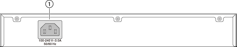

The rear panel of the Summit X440-8t switch provides an AC power input
socket. The internal AC power supply operates from 100 VAC to 240 VAC.
Summit X440-8p Switch Rear Panel
| 1 = AC power input connector |
