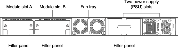

Summit X460-24t Switch Ports and Slots
The front panel of the Summit X460-24t switch includes:
- Twenty-four fixed autosensing 10/100/1000BASE-T ports (ports
1–24) that provide 24 Gbps of high-density copper connectivity
- Eight unpopulated SFP ports (ports 21–28) that provide 8 Gbps of
fiber connectivity. The SFP ports support both 100BASE-FX and 1000BASE-X optical
modules.
Ports 21 through 24 are implemented as shared ports
that pair a copper port with a fiber port. For more information about
combination ports, see Combination Ports and Failover.
For information about SFPs, see the Extreme Networks Pluggable Transceivers Installation
Guide.
- 10/100/1000 Mbps management port.
- Serial console port used to connect a terminal and perform local
management.
- LEDs to indicate port status and switch operating conditions.
For a description of the LEDs and their operation, see Summit X460 Series Switch LEDs.
- Stack number indicator.
Summit X460-24t Switch Front Panel
