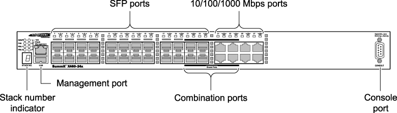

The front panel of the Summit X460-24x switch includes:
- Twenty-four unpopulated SFP ports (ports 1–24) that provide 24
Gbps of fiber connectivity. The SFP ports support both 100BASE-FX and 1000BASE-X
optical modules. For information about SFPs, see the Extreme Networks Pluggable Transceivers Installation
Guide.
- Eight fixed autosensing 10/100/1000BASE-T ports (ports 21–28)
that provide 8 Gbps of high-density copper connectivity.
- Ports 21 through 24 are implemented as shared ports that pair a copper port
with a fiber port. For more information about combination ports, see Combination Ports and Failover.
- Ports 1 through 28 support Synchronous Ethernet. For information about this
feature, see the .
- 10/100/1000 Mbps management port.
- Serial console port used to connect a terminal and perform
local management.
- LEDs to indicate port status and switch operating conditions.
For a description of the LEDs and their operation, see Summit X460 Series Switch LEDs.
- Stack number indicator.
Summit X460-24x Switch Front Panel
