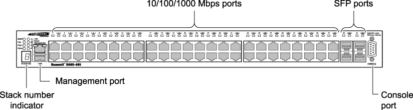

The front panel of the Summit X460-48t switch includes:
- Forty-eight fixed autosensing 10/100/1000BASE-T ports (ports
1–48) that provide 48 Gbps of high-density copper connectivity.
- Four unpopulated SFP ports (ports 49–52) that provide 4 Gbps of
fiber connectivity. The SFP ports support both 100BASE-FX and 1000BASE-X optical
modules. For information about SFPs, see the Extreme Networks Pluggable Transceivers Installation
Guide.
- 10/100/1000 Mbps management port.
- Serial console port used to connect a terminal and perform
local management.
- LEDs to indicate port status and switch operating conditions.
For a description of the LEDs and their operation, see Summit X460 Series Switch LEDs.
- Stack number indicator.
Summit X460-48t Switch Front Panel
