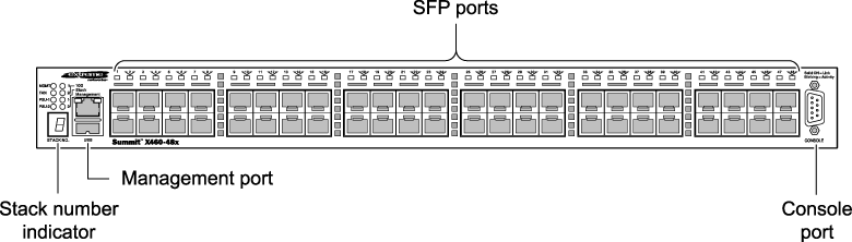

The front panel of the Summit X460-48x switch includes:
- All the front-panel ports on the Summit X460-48x switch support
Synchronous Ethernet. For information about this feature, see the . For information about SFPs, see the Extreme Networks Pluggable Transceivers Installation
Guide.
- 10/100/1000 Mbps management port.
- Serial console port used to connect a terminal and perform
local management.
- LEDs to indicate port status and switch operating conditions.
For a description of the LEDs and their operation, see Summit X460 Series Switch LEDs.
- Stack number indicator.
Summit X460-48x Switch Front Panel
