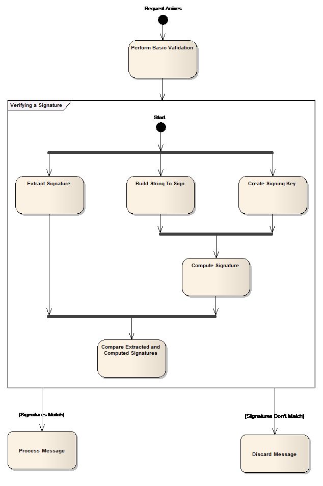

The following steps indicate the basic procedure for verifying the signature. Refer to Basic Flow for Verifying a Signature for the graphical flow.

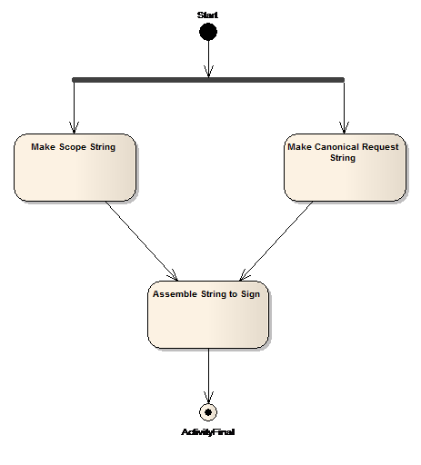

Steps in Building the String to Sign shows the main actions required to build the string that will be signed out of the request:
The scope string is easy to build out of a valid request. It is made from parts of the string in the “X-Amz-Credentials” parameter. If the credentials are valid then the scope string can be created by un-escaping the forward slashes it contains (i.e. replace ‘%2f‘ with ‘/‘), and then taking all the characters to the right of the first forward slash. The scope ends up being the fully qualified credential, less the identity string.
Parts of the Scope
The fully qualified Amazon credential consists of:
The canonicalized request string has the format:
"GET\n" .<URL-Path-Component>."\n" .<URL-Query-Parameters>."\n" .'host:'.<URL-Host> ."\n\nhost\nUNSIGNED-PAYLOAD";

               operator.Finally the string that will actually be signed is composed as:
"AWS4-HMAC-SHA256\n" .<Date>."\n" .<scope>."\n" .sha256(<canonicalized-request-string>)

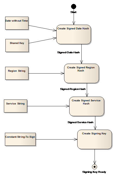

               output should be in the form of a string of lowercase hex digit characters.The process for generating signatures uses symmetric key encryption. The controller and the ECP use a shared key (the one configured on the controller‘s WLAN Service‘s captive portal configuration dialog) and the same encryption algorithm to generate and validate the signature.
The shared key is not used directly. Instead it is used to generate a secure hash (“HMAC”) that is then used as the key to sign the request. The process for creating the key is shown below in Creating the Signing Key.
In the above figure:
And each of the “Create…” actions consists of generating a secure HMAC using SHA256 from the inputs. The output secure hash is in binary format (not encoded as a hex character string). The output of each step acts as the signing key for the subsequent step. The signing key for the first step is the shared secret, pre-pended with the literal ‘AWS4‘.
Note that for any given identity the correct signing key only needs to be computed once per day. If the calculations are cached the cache should include an entry for the previous day to cope with the request being sent just before midnight UTC. The previous day‘s key only needs to be kept for a small overlapping period (perhaps 10 minutes at the most).
At this point the signature for the request is computed as a secure HMAC using SHA256. The signing key is created as described in Creating the Signing Key and the string to sign is created as described in Building the String to Sign.
Verifying the signature in the request consists of standard string comparison between the transmitted and computed keys. If they aren‘t identical the request is invalid. The client can be sent a web page containing a generic reject message or the request can be discarded silently.
