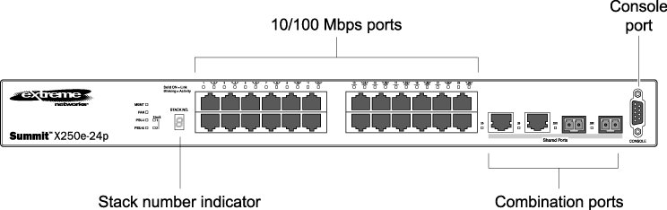

The front panel of the Summit X250e-24p switch includes:
- Twenty-four fixed autosensing 10/100BASE-T PoE ports (ports
1–24). In addition to 2.4 Gbps of high-density copper connectivity, these ports
also provide a full 15.4 Watts of PoE per port.
- Two combination ports (ports 25–26) using RJ45 connectors and
SFPs to provide 2 Gbps of copper or fiber connectivity.
For more information about combination ports, see Combination Ports and Failover.
For information about SFPs, see the Extreme Networks Pluggable Transceivers Installation
Guide.
- LEDs to indicate port status and switch operating
conditions.
For a description of the LEDs and their operation, see Summit X250e Series Switch LEDs.
- Stack number indicator showing the position of this switch in
a stacked configuration.
- Serial console port used to connect a terminal and perform
local management.
Summit X250e-24p Switch Front Panel

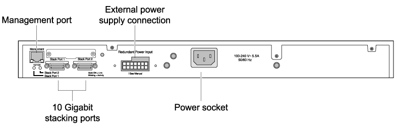

The rear panel of the Summit X250e-24p switch (shown in
Summit X250e-24p Switch Rear Panel)
includes:
- Ethernet management port with associated LEDs.
- Two high-performance stacking ports with associated
LEDs.
- Redundant power input connector for use with the EPS-500
External Power Supply (Model No. 10911) with full PoE power support.
The connecting redundant power supply cable is shipped
with the EPS-500 unit. See EPS-500 External Power Supply Unit for more information.
- AC power input socket.
The internal AC power supply operates from 100 VAC to 240
VAC.
