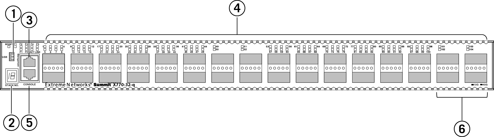

The front panel of the Summit X770-32q switch includes:
- 32 40-gigabit Ethernet ports capable of supporting passive
copper QSFP+ and active fiber QSFP+.
With quad fan-out SFP+
cables, the QSFP+ ports can be partitioned into 10-gigabit data lanes: 24 of the
ports can be partitioned into four 10-gigabit data lanes, and the remaining
eight ports can be used as single 10-gigabit data lanes. This yields a total of
104 10-gigabit ports as shown in X770 Port Numbers for 10G mode and 40G Mode:
Mode
For information about QSFP+ optical modules, see the Extreme Networks Pluggable Transceivers Installation
Guide.
- Groups of two or four ports configurable to be stacking ports
as shown in the following table:
X770 Stacking Method and Ports
| Stacking Method |
Ports |
| SummitStack-V |
103 and 104 |
| SummitStack-V160 |
103 and 104 |
| SummitStack-V-320 |
101 and 103, 102 and 104 |
When ports are used for stacking they are not available for normal Ethernet
connectivity. For more information about stacking, see Building Stacks.
- Management port (10/100/1000-Mbps).
- Front panel USB port for access to external storage.
- RJ45 RS-232c serial console port used to connect a terminal and
perform local management.
- LEDs to indicate port status and switch operating conditions.
For a description of the LEDs and their operation, see Summit X770 Series Switch LEDs.
- Stack number indicator.
| 1 = USB port |
4 = 40G/10G QSFP+ Ethernet ports |
| 2 = Stack number indicator |
5 = Console port |
| 3 = Management port |
6 = Stacking ports |

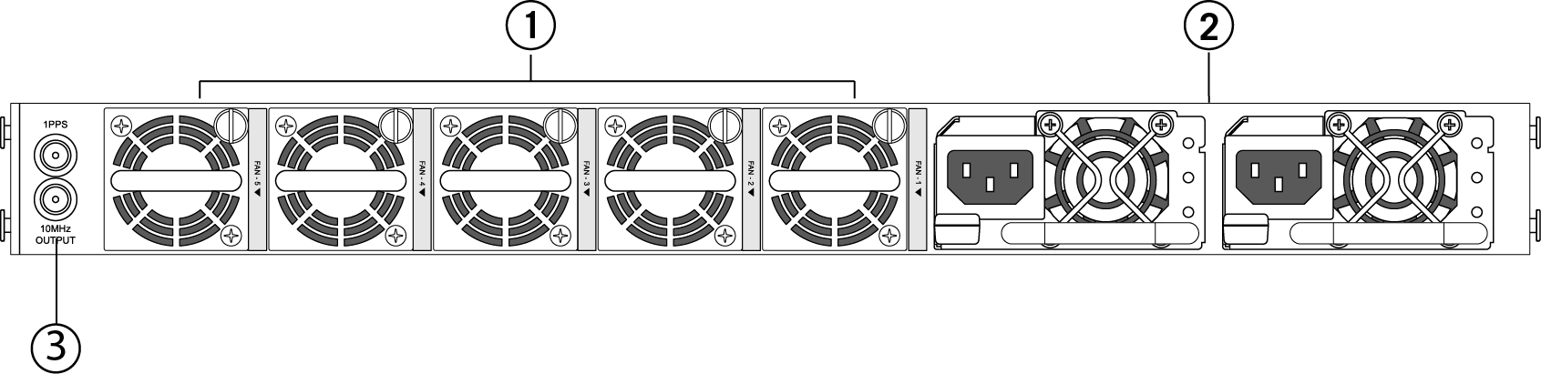

The rear panel of the Summit X770-32q switch includes:
- Five replaceable fan modules
- Two power supply bays for either AC or DC power supplies
(see Summit 550 W AC and DC Power Supplies).
- Two mini-BNC connectors labeled OUT for connecting a
Building Integrated Timing Supply (BITS) or GPS timing source:
- 1 PPS frame output
- 10 MHz output
| 1 = Fan modules |
3 = mini-BNC connectors |
| 2 = Power supply |
