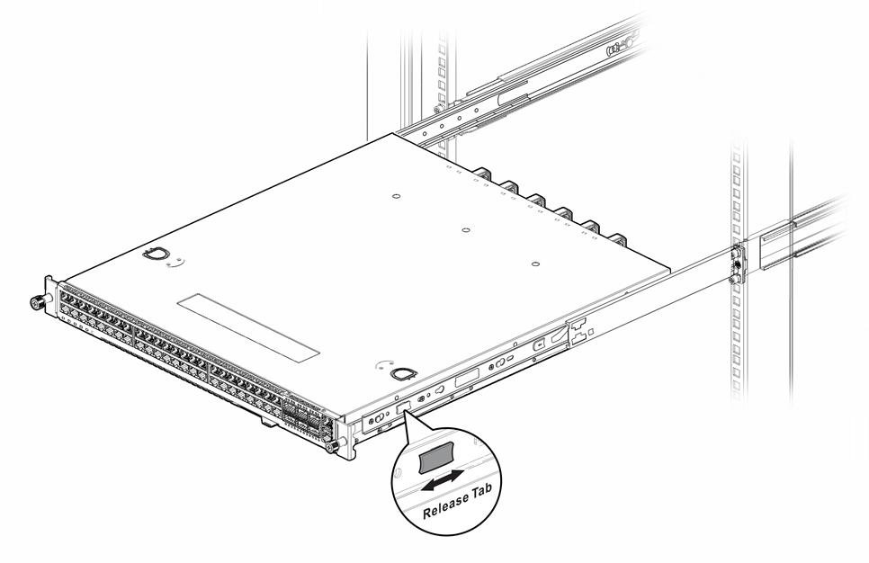

See Removing the Switch from the Slider Assemblies.
You can leave the slider assemblies in place. If you want to remove them, continue with step 3.d.

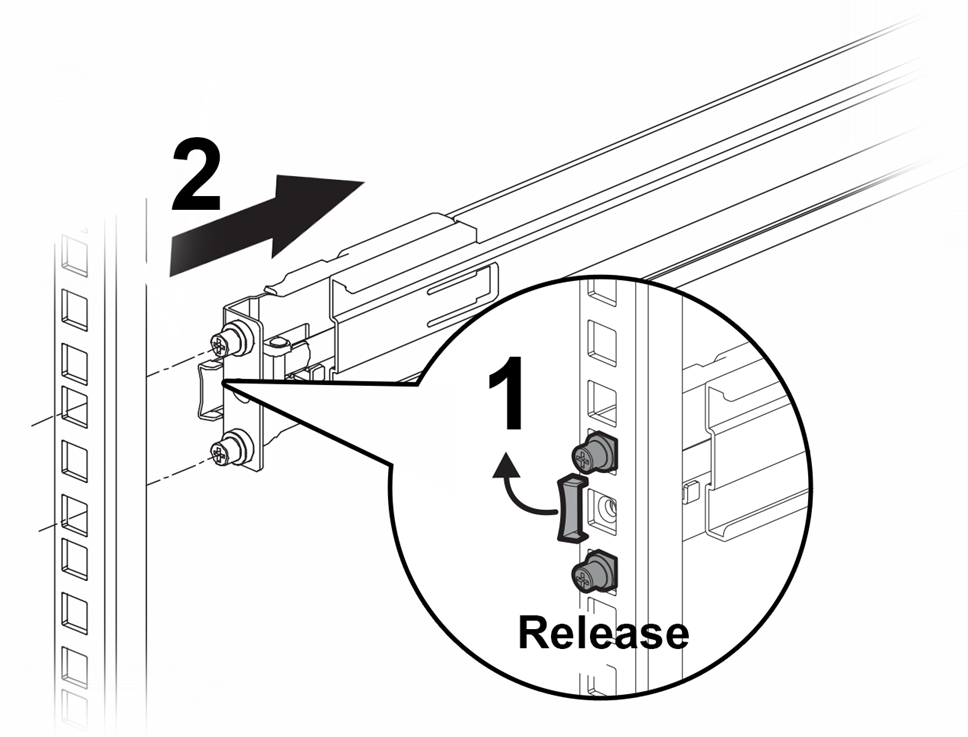

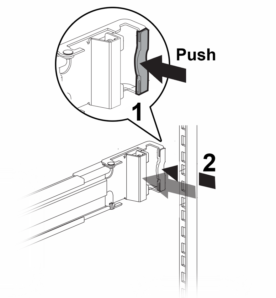

See Removing the Slider Assembly: Rear Rack Post.
See Removing the Slider Assembly: Front Rack Post.
