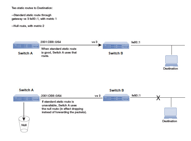

The following figure depicts how a null static route works with a standard route to the same destination.
Null route and standard route to same destination
The following procedure creates a preferred route and a null route to the same destination. The null route drops packets when the preferred route is not available.

  3. Configure the null route to the same destination with a higher metric.
    device(config)# ipv6 route 2001:DB8::0/64 null 0 2
    This example creates a null static route to the same destination. The metric is set higher so that the preferred route is used if it is available.
