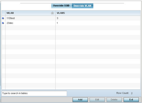

    The Override VLAN tab displays VLANs assigned to the access point‘s WLAN. Review existing VLAN assignment overrides, add new configurations or edit existing configurations.
    The Override VLAN main screen displays. This screen lists existing WLAN to VLAN assignments.
    WLAN Override - Override VLAN Screen
  2. Select Add to create a new WLAN to VLAN assigment. Or, select an existing configuration and click Edit to modify it.
