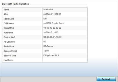

| Name | Lists the administrator assigned name of the access point‘s Bluetooth radio. |
| Alias | If an alias has been defined for the AP it is listed here. The alias value is expressed in the form of <hostname>: B<Bluetooth_radio_number>. If the administrator has defined a hostname for the AP, it is used in place of the AP‘s default hostname. |
| Radio State | Displays the current operational state (On/Off) of the Bluetooth radio. |
| Off Reason | If the Bluetooth radio is offline, this field states the reason. |
| Radio MAC | Lists the Bluetooth radio‘s factory-encoded MAC address serving as this device‘s hardware identifier on the network. |
| Hostname | Lists the AP's hostname as its network identifier. |
| Device MAC | Lists the AP‘s factory-encoded MAC address serving as this device‘s hardware identifier on the network. |
| AP Location | Lists the AP‘s administrator-assigned deployment location. |
| Radio Mode | Lists an Access Point‘s Bluetooth radio functional mode as either btsensor or le-beacon. |
| Beacon Period | Lists the Bluetooth radio‘s beacon transmission period from 100 -10,000 milliseconds. |
| Beacon Type | Lists the type of beacon currently configured. |
| Last Error | Lists descriptive text on any error that is preventing the Bluetooth radio from operating. |
