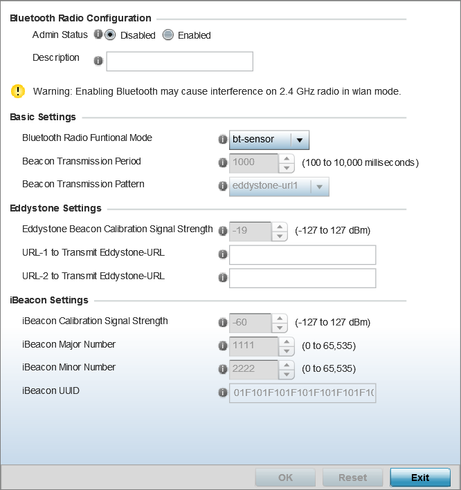

    Profile Overrides - Bluetooth Screen
  4. Set the following Bluetooth Radio Configuration parameters:

  5. Set the following Basic Settings:
    Bluetooth Radio Functional Mode Use this option to set the access point‘s Bluetooth radio functional mode. The options are:.

    Beacon Transmission Period Set the Bluetooth radio‘s beacon transmission period from 100 - 10,000 milliseconds milliseconds. As the defined period increases, so does the CPU processing time and the number packets incrementally transmitted (typically one per minute). The default setting is 1,000 milliseconds.
    Beacon Transmission Pattern When the Bluetooth radio‘s mode is set to le-beacon, use the enabled drop-down menu to set the beacon‘s emitted transmission pattern to eddystone_url1, eddystone_url2, or ibeacon.

  6. If setting the Beacon Transmission Pattern to eddystone_url1 or eddystone_url2, define the following Eddystone Settings settings:
    Eddystone Beacon Calibration Signal Strength Set the Eddystone Beacon measured calibration signal strength, from -127 dBm to 127 dBm, at 0 meters. Mobile devices can approximate their distance to beacons based on received signal strength. However, distance readings can fluctuate since they depend on several external factors. The closer you are to a beacon, the more accurate the reported distance. This setting is the projected calibration signal strength at 0 meters. The default setting is -19 dBm.

  7. If setting the Beacon Transmission Pattern to ibeacon, define the following iBeacon Settings:
    Beacon Calibration Signal Strength Set the iBeacon measured calibration signal strength, from -127 dBm to 127 dBm, at 1 meter. Mobile devices can approximate their distance to beacons based on received signal strength. However, distance readings can fluctuate since they depend on several external factors. The closer you are to a beacon, the more accurate the reported distance. This setting is the projected calibration signal strength at 1 meter. The default setting is -60 dBm.
