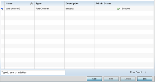

Profiles can utilize customized port channel configurations as part of their interface settings. Existing port channel profile configurations can be overridden as they become obsolete for specific device deployments.
To define or override a port channel configuration on a profile:
A blue override icon (to the left of a parameter) defines the parameter as having an override applied. To remove an override go to the Basic Configuration section of the device and click Clear Overrides. This removes all overrides from the device.| Name | The port channel's numerical identifier assigned when it was created. The numerical name cannot be modified as part of the edit process. |
| Type | Whether the type is port channel. |
| Description | A short description (64 characters maximum) describing the port channel or differentiating it from others with similar configurations. |
| Admin Status | A green check mark means the listed port channel is active and currently enabled with the profile. A red “X” means the port channel is currently disabled and not available for use. The interface status can be modified with the port channel configuration as required. |
After reviewing the configurations of existing port channel interfaces, determine whether a new interface needs to be created, an existing interface needs to be edited (overridden), or an existing interface needs to be deleted.
