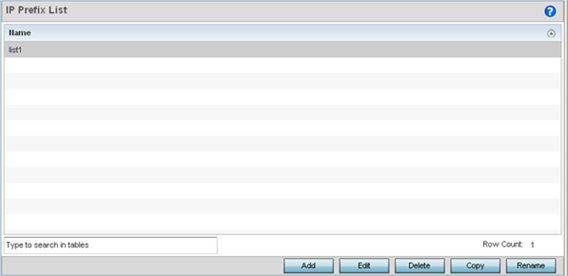

IP prefix lists are a convenient way to filter networks in BGP supported networks. IP prefix lists work similarly to access lists. A prefix list contains ordered entries processed sequentially. Like access lists, the evaluation of a prefix against a prefix list ends as soon as a match is found.
To restrict the routing information advertised, use filters consisting of an IP prefix list applied to updates both to and from neighbors.
To define an IP prefix list:

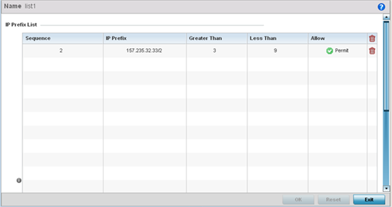

| Sequence | Supply a sequence number to determine the prefix utilization order for existing lists. |
| IP Prefix | Set the IP prefix used as an prefix list rule. |
| Greater Than | Specify a greater than or equal to value for an IP prefix range. |
| Less Than | Specify a less than or equal to value for an IP prefix range. |
| Allow | Use the drop-down menu to set a Permit or Deny designation to the rule configuration. |
