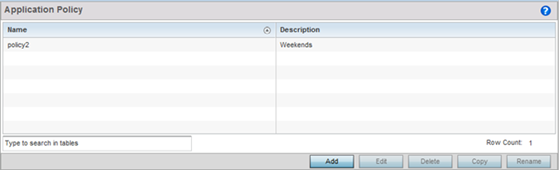

Select .
The screen lists the
application policy configurations defined thus far.
Refer to the following to determine whether a new application policy requires
creation, modification or deletion:
| Name |
Lists the 32 character maximum name assigned to each
listed application policy, designated upon creation. |
| Description |
Displays the 80 character maximum description assigned to
each listed application policy, as a means of further
distinguishing policies with similar configurations. |
Select Add to create a new application policy,
Edit to modify the attributes of a selected policy or
Delete to remove obsolete policies from the list of
those available. Existing policies can be copied or renamed as needed.

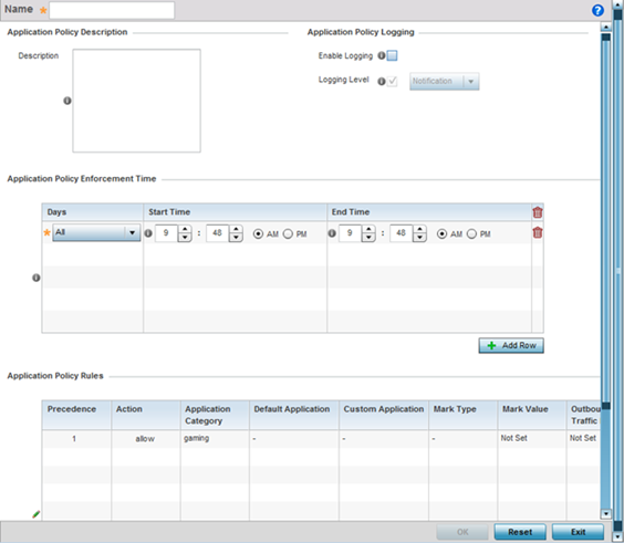

If creating a new application policy, assign it a Name
up to 32 characters.
Provide this application policy an 80 character maximum
Description to highlight its application and category
filters and differentiate it from other policies with similar
configurations.
Define the following Application Policy Logging options to
enable and filter logging for application specific packet flows:
| Enable Logging |
Enables the log functionality, where each new flow is
shown with the corresponding matched application, the action
taken and the policy name. When enabled, logging just shows
what applications are getting recognized. |
| Logging Level |
Select this option to log application events by severity.
Severity levels include Emergency, Alert, Critical, Errors,
Warning, Notification, Information and Debug. The default
logging level is Notification. |
Refer to the Application Policy Enforcement Time table
configure time periods for policy activation for each policy.
Select + Add Row to populate the table with an
enforcement time configuration to activate application policies based on the
current local time. The option to configure a time activation period is
applicable for a single application policy. Configure the days and time period
when the application policy is enforced. If no time enforcement configuration is
set, the policy is continually in effect without restriction.
Refer to the Application Policy Rules table assess
existing policy rules, their precedence (implementation priority), their actions
(allow, deny etc.), application category and schedule policy enforcement
restrictions.

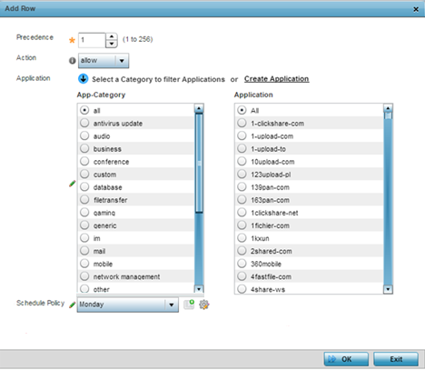

Select + Add Row to launch a screen to create a new
policy rule.
Assign the following attributes to the new application rule policy:
| Precedence |
Set the priority (from 1 - 256) for the application
policy rule. The lower the value, the higher the priority
assigned to this rule‘s enforcement action and the category
and application assigned. A precedence also helps resolve
conflicting rules for applications and categories. |
| Action |
Set the action executed on the selected application
category and application. The default setting is
Allow. |
| Application |
From the App-Category table, select the category for
which the application rule applies. Selecting All
auto-selects All within the Application table. Select All
from the Application table to list all application category
statistics, or specify a particular category name to display
its statistics only. |
Use the Schedule Policy drop-down menu to select an
existing schedule policy to strategically enforce application filter policy
rules for specific intervals. This provides stricter, time and schedule based,
access or restriction to specific applications and their parent categories. If
an existing policy does not meet requirements, either select the
Create icon to configure a new policy or the
Edit icon to modify an existing policy. For more
information on configuring schedule policies, see Schedule Policy
