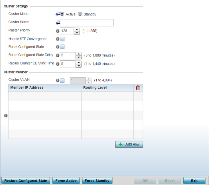

    The Cluster override configuration screen displays.
    Device Configuration - Profile Overrides - Cluster Configuration Override Screen
  4. Define the following Cluster Settings overrides:
    Cluster Mode
    A member can be in either an Active or Standby mode. All active member controllers or service platforms can adopt access points. Standby members only adopt access points when an active member has failed or sees an access point that‘s not yet adopted. The default cluster mode is Active and enabled for use with the profile.
    Cluster Name
    Define a name for the cluster name unique to its configuration or profile support requirements. The name cannot exceed 64 characters.
    Master Priority
    Set a priority value from 1 and 255 with the higher value being given higher priority. This configuration is the device‘s priority to become cluster master. In cluster environment one device from cluster members is elected as cluster master. This configuration is the device‘s priority to become cluster master. The default is 128.
    Handle STP Convergence
    Select the radio button to enable Spanning Tree Protocol (STP) convergence for the controller or service platform. In general, this protocol is enabled in layer 2 networks to prevent network looping. Spanning Tree is a network layer protocol that ensures a loop-free topology in a mesh network of inter-connected layer 2 controller or service platform. The spanning tree protocol disables redundant connections and uses the least costly path to maintain a connection between any two controllers or service platforms in the network. If enabled, the network forwards data only after STP convergence. Enabling STP convergence delays the redundancy state machine execution until the STP convergence is completed (the standard protocol value for STP convergence is 50 seconds). Delaying the state machine is important to load balance APs at startup. The default setting is disabled.
    Force Configured State
    Select the radio button to allow this controller or service platform to take over for an active member if it were to fail. A standby controller or service platform in the cluster takes over APs adopted by the failed active member. If the failed active member were to come back up, the active member starts a timer based on the Auto Revert Delay interval. At the expiration of the Auto Revert Delay, the standby member releases all adopted APs and goes back to a monitoring mode. The Auto Revert Delay timer is stopped and restarted if the active member goes down and comes up during the Auto Revert Delay interval. The default value is disabled.
    Force Configured State Delay
    Specify a delay interval in minutes (3 - 1,800). This is the interval a standby member waits before releasing adopted APs and goes back to a monitoring mode when an active cluster member becomes active again after a failure. The default interval is 5 minutes.
    Radius Counter DB Sync Time
    Specify a sync time (from 1 - 1,440 minutes) a RADIUS counter database uses as its synchronization interval with the dedicated NTP server resource. The default interval is 5 minutes.
  5. Within the Cluster Member field, select Cluster VLAN to enable a spinner control to designate the VLAN where cluster members are reachable. Specify a VLAN from 1 - 4094.
    Specify the IP addresses of the VLAN‘s cluster members using the Member IP Address table.
  6. Select Restore Configured State to restore this cluster member back into role of taking over for an active member if it were to fail.
  7. Select Force Active to revert this cluster member back into its default active state and provide the ability to adopt access points.
  8. Select Force Standby to only adopt access points when an active member has failed or sees an access point that‘s not yet adopted
  9. Select OK to save the changes and overrides made to the profile‘s cluster configuration.
    Select Reset to revert to the last saved configuration.
