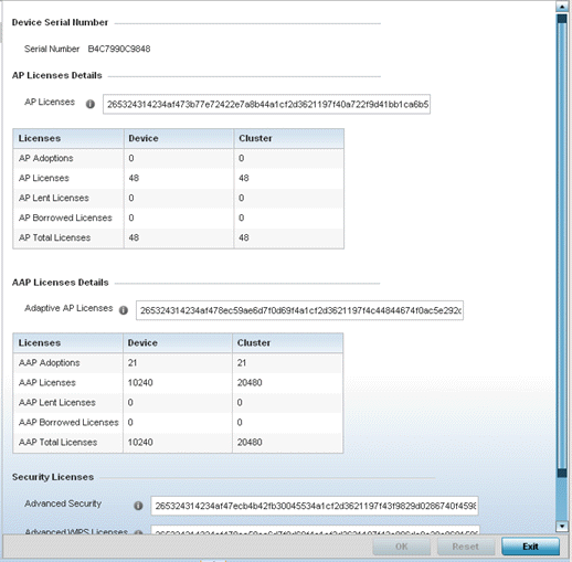

The Licenses screen also contains a facility where new licenses can be applied to increase the number of device adoptions permitted, or to allow the use of the advanced security features.
Each controller and service platform family has multiple models to choose from that range from zero licenses to the maximum number that can be loaded for that specific SKU.
To configure a device‘s a license configuration:
The License screen displays the Device Serial Number of the controller or service platform generating the license key.
When assessing lent and borrowed license information, it is important to distinguish between NOC controllers and site controllers.NOC controllers are NX 95XX and NX 96XX.
The site controllers are RFS 4000, NX 5500, and NX 7510.
| AP Adoptions | The Device column lists the total number of AP
adoptions made by the controller or service platform. If the
installed license count is 10 APs and the number of AP
adoptions is 5, five additional APs can still be adopted
under the terms of the license. The total number of APs
adoptions varies by platform, as well as the terms of the
license. The Cluster column lists the total number of AP adoptions made by the cluster membership (all members). If the installed license count is 100 APs and the number of AP adoptions is 50, 50 additional APs can still be adopted under the terms of the AP licenses, pooled by the cluster members. |
| AP Licenses | The Device column lists the number of APs
available for adoption under the restrictions of the
license. This number applies to dependent mode adaptive APs
only, and not independent mode APs. The Cluster column lists the number of APs available for adoption by cluster members under the restrictions of the licenses, as pooled amongst the cluster members. |
| AP Lent Licenses | Lent licenses are the total number of AP licenses the NOC controller lends (if needed) to its site controllers so that a site controller can adopt APs in excess of its own installed AP license count. AP lent licenses can be non-zero only in controllers currently configured as the NOC (NOC controller). Lent Licenses is always zero in controllers configured as the site (site controller). |
| AP Borrowed Licenses | Borrowed licenses are the total number of AP licenses borrowed by the site controller from the NOC controller (NOC controllers if a NOC controller is in a cluster). AP borrowed licenses are always zero in the NOC controller. AP borrowed licenses can be non-zero only on site controllers. |
| AP Total Licenses | The cumulative number of both Device and Cluster AP licenses supported by the listed controller or service platform. |

| AAP Licenses | The Device column lists the number of AAPs
license. This number applies to dependent mode adaptive AAPs
only, and not independent mode AAPs. The Cluster column lists the number of AAPs available for adoption by cluster members under the restrictions of the licenses, as pooled amongst the cluster members. |
| AAP Lent Licenses | Lent licenses are the total number of AAP licenses the NOC controller lends (if needed) to its site controllers so site controllers can adopt adaptive APs in excess of its own installed AAP license count. AAP lent licenses can be non-zero only in controllers currently configured as the NOC (NOC controller). Lent licenses is always zero in controllers configured as the site (site controller). |
| AAP Borrowed Licenses | Borrowed licenses are the total number of AAP licenses borrowed by the site controller from the NOC controller (NOC controllers if a NOC controller is in a cluster). AAP borrowed licenses are always zero in the NOC controller. AAP borrowed licenses can be non-zero only on site controllers. |
| AAP Total Licenses | Lists the cumulative number of both Device and Cluster AAP licenses supported by the listed controller or service platform. |
| Advanced Security | Enter the provided license key required to install the Role Based Firewall feature and increase the number of IPSec VPN tunnels. The number of IPSec tunnels varies by platform. |
| Analytics Licenses | Enter the provided license key required to install Analytics (an enhanced statistical management tool) for NX 95XX and NX 96XX series service platforms. |
