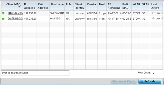

The Guest User screen displays read-only device information for guest clients associated with the selected controller or service platform. Use this information to assess if configuration changes are required to improve performance.
To view a controller or service platform‘s connected guest user client statistics:
The screen displays.
