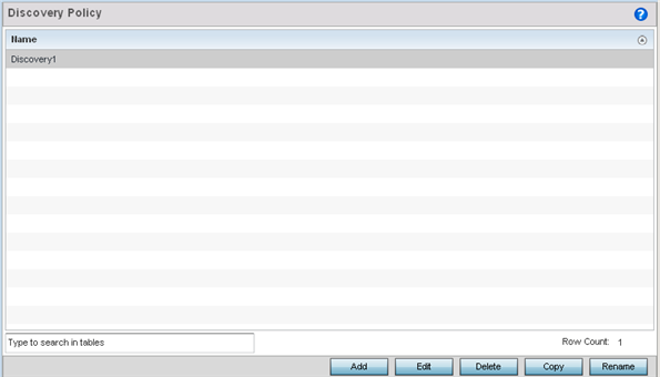

To display Bonjour discovery policy information:
Optionally, Rename a policy or Copy a policy to a different location.

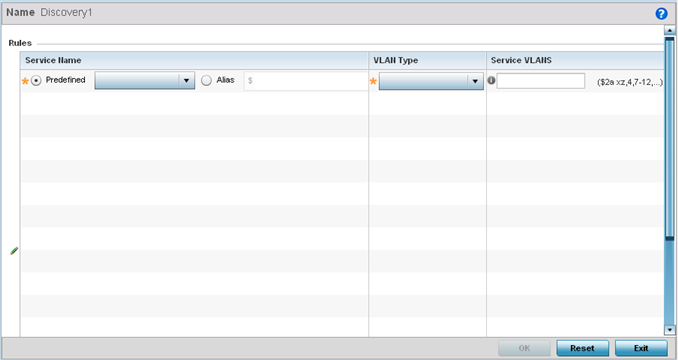

| Service Name | Define the service that can be
discovered by the Bonjour gateway.
| VLAN Type | Use the drop-down menu to select
the VLAN type.
| Service VLANs | Provide a VLAN or a list of VLANs on which the selected service is discoverable. |
| Instance Name | Optionally, specify the selected
Bonjour service‘s instance name. When specified, the Bonjour
service discovery queries contain the instance name. of the
service to be discovered. You can either directly specify
the string value to be used as a match criteria, or use a
string alias (for example, $BONJOURSTRING) to identify the
string to match. If using a string alias, ensure that it is
existing and configured. For information on configuring a
string alias, see Network Basic Alias Configuration. This option is useful especially in large distributed, enterprise networks. Use it to create different instances of a Bonjour service for the different organizations or departments (VLANS) within your network. Creating instances allows you to advertise specific service instances for a specific set of VLANs, instead of advertising top-level Bonjour Services to various allocated VLAN(s). |
