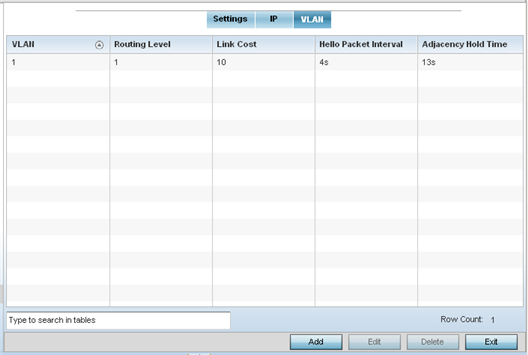

Select the VLAN tab to display the link IP VLAN information shared by the devices managed by the MiNT configuration.
The VLAN tab displays the VLAN, Routing Level, Link Cost, Hello Packet Interval and Adjacency Hold Time managed devices use to securely communicate amongst one another. Select Add to create a new VLAN link configuration or Edit to update an existing MiNT configuration.

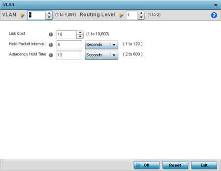

Set the following VLAN parameters to complete the MiNT configuration:
VLAN |
Define a VLAN ID between 1 - 4,094 used by peers for interoperation when supporting the MiNT protocol. |
Routing Level |
Use the spinner control to define a routing level of either 1 or 2. |
Link Cost |
Use the spinner control to set a link cost between 1 - 10,000. The default value is 100. |
Hello Packet Interval |
Set an interval in either Seconds (1 - 120) or Minutes (1 - 2) for the transmission of hello packets. The default interval is 15 seconds. |
Adjacency Hold Time |
Set a hold time interval in either Seconds (2 - 600) or Minutes (1 - 10) for the transmission of hello packets. The default interval is 46 seconds. |
Select OK to save the updates to the MiNT Protocol configuration. Select Reset to revert to the last saved configuration.
